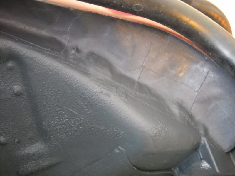

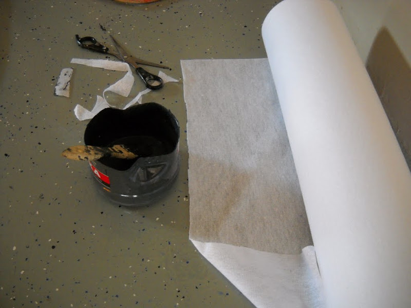

And, in his spare time, George sealed the front wheel wells; you could literally see the door hinges after the factory plastic inner wheel wells were removed and the fenders were cut. Here's George's roofing experience at work; he used black roof primer (Home Depot) and the webbing he gets from his distributer, Armor Coat. He uses these materials as you would papier mache or fiberglass, layering it in and forming it to shape:
Looking up:
He used 2 coats of web and primer, and painted the entire wheel well with the primer for a nice factory look:
Here's the goods:

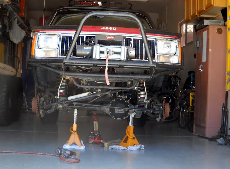

Diane - 4 of Number 7
  #88
Old 4 Weeks Ago
dzJeepChic's Avatar
dzJeepChic dzJeepChic is offline
Founder/Administrator
Location: Fountain Hills, AZ
Posts: 1,270
Default Re: dzJeepChic's '92 XJ Expedition Vehicle Project
I'm not exaggerating:

Is George in there somewhere?! What is going on here, did George buy that hub kits that someone was selling? Looks like he is working on "outers."
-Allen, KE7TOG
"60% of the time, it works all the time."
  #90
Old 4 Weeks Ago
dzJeepChic's Avatar
Posts: 1,270
Most of the time.
He turned the gift certificate he won at the 4 Peaks Clean-up into a store credit at SDHQ & they ordered it for us; partially paid for it. So yeah, he's installing free-spin hubs among other things. d
